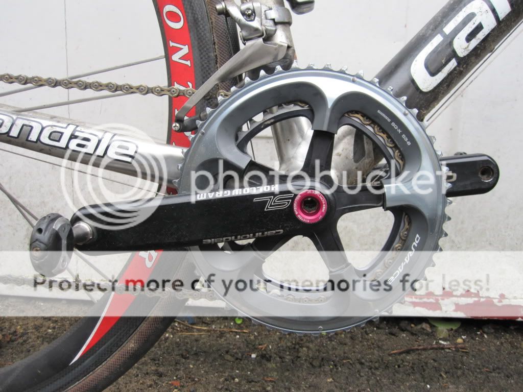

PostPosted: Sat Jun 09, 2012 8:50 am
Formerly known as CAADHEAD
Posts: 1358
Location: WALES,UK
It may not be pretty but it sure shifts well, even more so since I binned the pictured Red front mech and slapped a 7900 front mech on 8)
Whats needed is a dedicated 7900/Hollogram front spider that matches the shapes of the rings or at least a plastic/carbon fibre cover that clips into place over the existing spider to blend the shape of the outer ring better. Project for someone?
