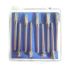

So what tips are you guys using on your dremels? I have a few tips but need to get some extra tips. I need one that removes a lot of material then some for doing more fine scupting and would like to know what you guys use.

http://www.amazon.com/diameter-head-Shank-Carbide-Burr/dp/accessories/B0007OTC0S
