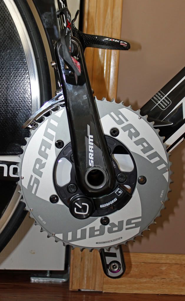

Joined: Sun Jan 04, 2009 10:04 am
Posts: 39
Location: Prague, CZE
without problems shift nice this 53t. and inner 39t.
[img]IMG_2158.JPG[/img]
