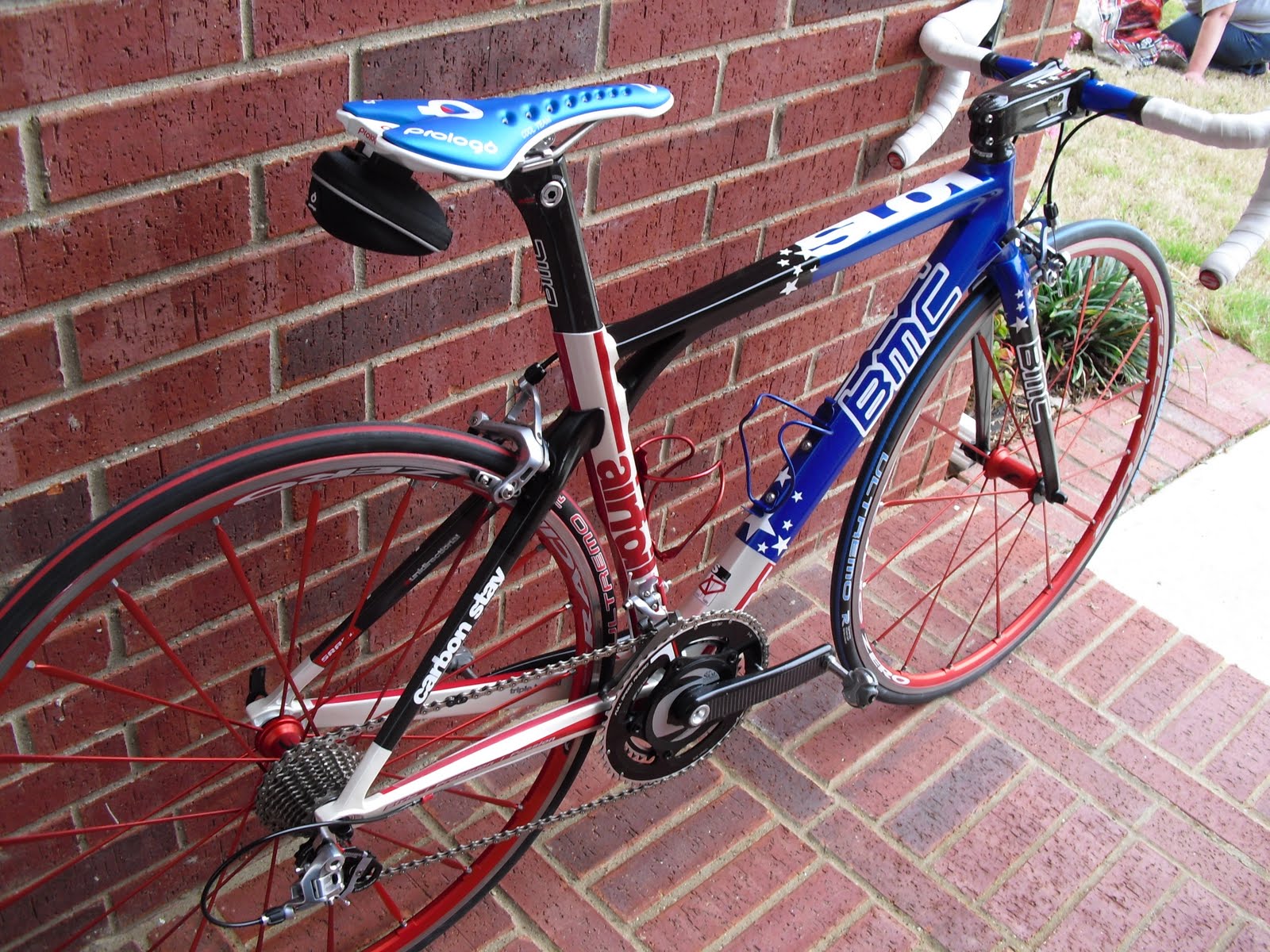

Does it have to be perfect? Seriously? Or just pretty good? If the latter is your answer then just do it yourself. You DON'T need an automotive gun. For a bike frame a little paint goes a LOOONNNGG way. Get yourself a decent airbrush/compressor and use some House of Kolor paint in amounts for doing RC or models. Thinned paint sprays for a long time. My airbrush and compressor is less than $100.
The main thing is prep work and practice on some pvc pipe with some cheap paint/water/ just to get used to it. Clear is toxic but the volume is small so I don't think you need a big respirator, etc. Just a mask and some ventilation...outside...stuff is bad stink.
My paint jobs weren't perfect but I did this with an airbrush and some HOK paint. Looks alright and I could have done better with practice.
http://4.bp.blogspot.com/_Udu-1IjbBNE/S7n7s-DtqkI/AAAAAAAAAXQ/cHmtFgbf-_w/s1600/CIMG0741.JPG
If you really want a professional job then call Jack here and get a quote. Tell him Gary sent you and see if you can get a price break (no guarantees).
http://www.kanebikes.com/gallery_index.cfm?ID=6
