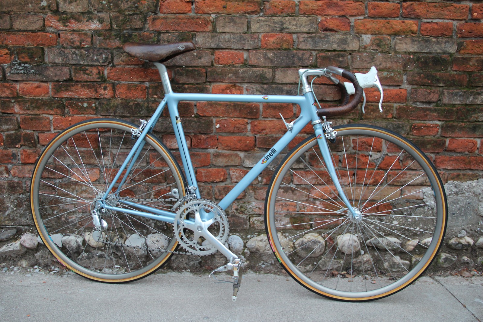

So they compare a Venge, which is designed to be as aero as possible, with a regular round tubed frame from the 1980's? Pointless exercise IMO as they are comparing apples to oranges. Far more relevant would be to compare it to a frame built from aero tubing in the 80's such as a Cinelli Laser Strada.

I disagree and think it gave a great present-day comparison of what you gain (or lose) in an aero frame (which isn't the top of the 'aero tree' either) versus a standard round tube offering.
As I am sure there are plenty more riders tossing up between an aero frame or a standard frame as opposed to a Venge or a Cinelli Laser Strada.

ultimobici wrote:So they compare a Venge, which is designed to be as aero as possible, with a regular round tubed frame from the 1980's? Pointless exercise IMO as they are comparing apples to oranges. Far more relevant would be to compare it to a frame built from aero tubing in the 80's such as a Cinelli Laser Strada.
I disagree. It was a great comparison. On the internet when aero is mentioned and a discussion starts, someone always mentions old school steel frame with small diameter tubes and how they wonder how that would compare against a modern carbon aero frame. Well, Specialized did a test and tried to compare as best they could. It is an apples to apples comparison in terms of the question being answered: small diameter steel vs modern aero carbon frame. Will finally put that response to rest as it has always been replied with tube shape matters more than tube size.
