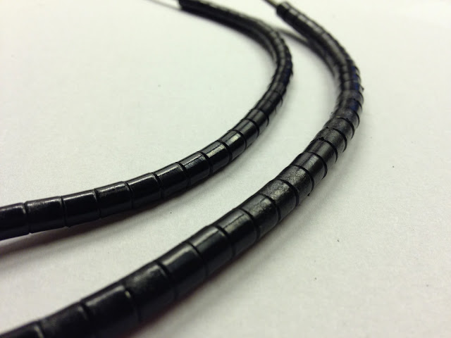

Hi guys, it's almost three weeks since my last post.
Sice then we've been busy, working on moulds, fine-tuning the design, trying out different variations of the material.
@sugarkane, I considered lining the cables the way you suggested, I even made a prototype that was self lined however it didn't come out as good as I expected it to. The problem is dirt getting inside the lining as the design of cable links is much more "opened" as Aikan's design.
Here are some photos that I took in the past few weeks:
Raw kevlar reinforced nylon composite:
Some prototype cable links, made out of kevlar composite instead of carbon (the material wasn't as good as carbon plus the moulds had to be corrected - therefore the links were s*itty):
Here is the latest product of our development, left is the shifter and right is the brake cable housing... At the moment I'm working on smoothing the surface, as some links apear to be a bit rough:
I'm pretty satisfied with the flexibility:
Compared to Nokon cable housings:
Keep the wind at your back and the sun on your face!

Quote: At the moment I'm working on smoothing the surface, as some links appear to be a bit rough:unquote
Valant,hope you will find a way to polish them . Working on the molds for that reason will make your product heavier :wink:
New molds :noidea:
Wish you all the best on the way to the end product. :thumbup:

Have you considered tumble finishing with shot to clean them up rather trying to perfect the moulds?
Anyway as a fellow mech eng all the best with the project and don't forget that proper testing before release to market involves lots of users in different conditions with different set ups... :D
