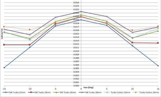

1 watt per wheel at dead on head wind. A lot more different in cross wind as beaver's graph suggest though.
beaver:
Silca blogs call that data as 105% rule where if rim is at least 105% as wide as tire then it wouldn't effect aero-ness of the rim at all. But data it established from is from U-shape rim test where brake track is significantly narrower than the widest section. Put a wide tire on there it'll be '8' shape instead of Toroidal 'U' shape as designer intended.
In the picture Zipp 404 (old) is 26.53mm wide at the widest point. 105% rule suggest tire size at or narrower than 26.53/1.05=25.02mm which is pretty close to 24.72mm that is brake track width.
23c (24.8mm) and 25c at 6bar pressure (26.1mm) are both still perform very good despite being a bit wider than brake track. Also, from FLO's yaw data record we shouldn't care about wind at 15 degree yaw or more at all as it is very rare when we are going high speed so the 25c at 7bar (26.5mm) should also be quite good in aero-ness too except in extreme yaw angle wind of course.
So i think for V-shaped rims the 105% rule could be relaxed since the widest part of the rim is on the brake track itself. Tire overhang of 0-1.4mm over brake track is just extension of the delta shape that wouldn't effect aero-ness much.
what do you think?

The 105% rule was initiated by Bontragers aero tests: https://www.google.de/url?sa=t&rct=j&q= ... cA&cad=rja
When the rim is wider than the tire at the brake track, the airflow will be led around the rim instead of loosing connection directly at the tire in crosswinds:
The Zipp and Easton rims shown would be dramatically better with narrower tires (on the front, on the rear a little tire overhang is even better)...
This positive effect is also measured here with a Roval CLX 64 wheel:
As the torodial rims are thinner at the brake track, wider tires will have a worse effect than on a V shape rim with a wide brake track. I am running U shape 28mm wide 21C NOX S36R rims with a 25mm tire (real width 28.5mm) and the transition is quite smooth. So yes, with little tire overhang everything will be fine.
With 23mm tires my rims would be better aerodynamically, but I need some mm more for the bad roads. :(
