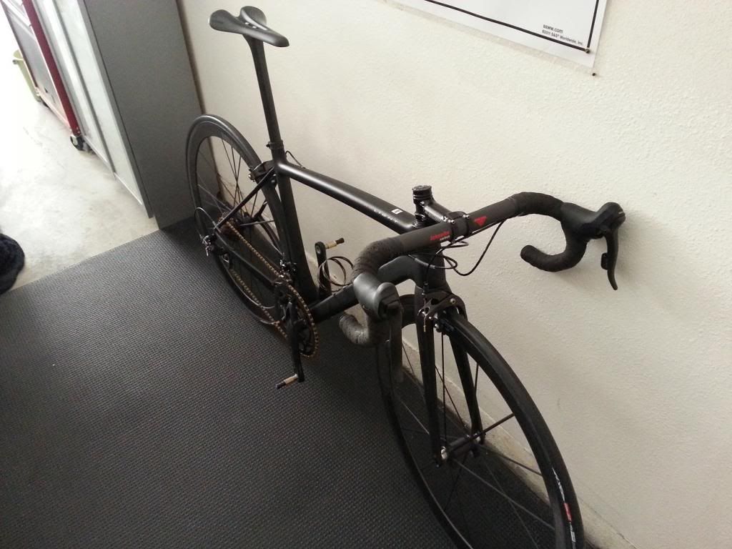

Hello,
I thought I would put together a BH Ultralight with some weenie parts. If I can drop weight elsewhere, please let me know how. I used AICAN Bungarus housing with PowerCordz for shifting. The performance on this combination is absolutely terrible as the PoweCordz seem to stick inside the housing/liner. Any advice on how to get this combo to work better would be appreciated. I am probably gonna just switch them out to steel cables or maybe the KCNC Ti Cables. I was also thinking about using the Ax Lightness Ax6000 fork that I have. I decided not too because I wanted to live past my 40th birthday. The Cirrus Ultralite Ti pedals are also very scary as it is not an easy task to clip out of them. In fact, I snapped my TUNE bottle cage trying to get my right foot out of them. I will probably switch the pedals out too. Thanks for looking :)
FRAME: 2014 BH ULTRALIGHT SIZE SMALL
STEM: EXTRALITE ULTRASTEM OC (I AM CURRENTLY WAITING FOR MCFK STEM)
TOPCAP: EXTRALITE W EXTRALITE BOLT
HEADSET EXPANDER: EXTRALITE ULTRASTAR 2
SPACERS: EXTRALITE DELRIN
HEADSET : EXTRALITE ULTRATOP
FSA HEADSET FOR BOTTOM (EXTRALITE ULTRABOTTOM DID NOT WORK.....TOO MUCH PLAY....AFRAID I WOULD CRACK FRAME)
HANDLEBAR: SCHMOLKE TLO OS
SHIFTERS: SRAM RED 10 SPEED WITH BTP CARBON CLAMPS
BRAKES: AX LIGHTNESS ORION
BRAKE PADS: REYNOLDS BLUE
BRAKE CABLES: KCNC TI CABLES
SHIFT CABLES: POWERCORDZ (THEY SUCK!)
HOUSING: AICAN BUNGARUS
SADDLE: DASH
SEATPOST: DASH 350MM
SEATPOST CLAMP: MCFK SUB5
F DERAILLEUR: SRAM RED (NON YAW)
R DERAILLEUR: SRAM RED 10 SPEED
CASSETTE: KCNC TI 12-25
CRANKSET: THM CLAVICULA 170MM WITH FIBRELYTE PRELOAD CAP
CHAINRINGS: FIBRELYTE 53x39
CHAINRING BOLTS: KCNC SL
BOTTOM BRACKET: THM BB386
PEDALS: ULTRALITE CIRRUS TI
CHAIN: KMC X11SL
DERAILLEUR PULLEYS: ROTHSHEK CARBON
WHEELSET: LEW PRO VT-1
TIRES: TUFO ELITE JET
WATER BOTTLE CAGE: TUNE SKYLINE
SKEWERS: TUNE SKYLINE
BAR TAPE: DEDA TRAFORATO
BH Ultralight
Litespeed Ghisallo
Scott Addict Singlespeed

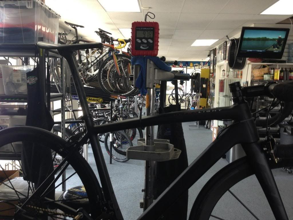

To all that are curious about the frame and fork weights here they are. The Ax Lightness fork is much lighter (uncut weight) but I cannot find the courage to ride it.

very nice build, but I am less than impressed with the frame weight. Did that include all the required hardware (bottle cage bolts, internal routing pieces, rear der hanger etc?)
I say this because my size large frame came in at 2 grams heavier (825 g)
The New: BH http://weightweenies.starbike.com/forum/viewtopic.php?f=10&t=117760
The Old: Trek http://weightweenies.starbike.com/forum/viewtopic.php?f=10&t=110051
PostPosted: Sat May 10, 2014 9:56 pm
Joined: Sat Jul 28, 2012 11:31 pm
Posts: 389
When I put together the bike, the frame was the last thing I purchased as I was deciding between the BH ultralight, the 2014 Addict SL or the Ax Lightness Vial EVO. I went with the BH because I liked the black on black color scheme and wanted to try out the BB386 BB standard. The frame weight did surprise me somewhat as I was expecting a lighter weight for a size small. The weight includes the derailleur hanger and the internal cable guides (blue cables that you remove after installing cables). Before weighing the frame, I removed the bottle cage bolts and cable stop panels. I was really hoping for a sub 800 gram weight. It seems that the 2013 and 2014 models with the internal cable routing weigh a little more than the 2012 version with the external cable guides.

PostPosted: Sat May 10, 2014 10:30 pm
Posts: 775
Location: muc
godzuki26 wrote:
..... I was really hoping for a sub 800 gram weight. ......
guys....you are crazy! :wink:
30 or 40 gramm more or less...sorry. who cares??
i think, this is a very beautiful frameset, and an impressive build.
the ax-fork seems not to be made for tapered head-tubes. combining it with the bh-frame might cause some problems?
btw: claimed frame-weight is 750 gramm. without specification of size, so, as you can imagine, its related to smallest size xxs. and manufactorers use to weigh naked frames, without anything.
so, i think, 823 gramm for size "s"-Frame, with hanger and cable guides, is absolutely ok.;-)
sorry vor mai bed englisch!

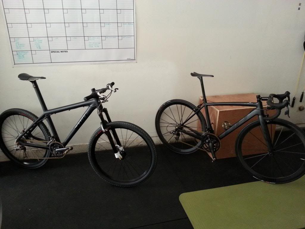

@ Dan W the mtb is:
FRAME: 2009 SCOTT SCALE RC SIZE M
STEM: EXTRALITE ULTRASTEM UL3
TOPCAP: TUNE CARBON TOPCAP AND BOLT
HEADSET : TUNE BUBU
HANDLEBAR: MCFK STRAIGHT BAR
SHIFTERS: SRAM XX GRIPSHIFT
BRAKES: FORMULA R1 RACING
ROTORS: SCRUB
BRAKE CABLES: ALLIGATOR ILINK STEEL
SHIFT CABLES: ALLIGATOR ILINK STEEL
HOUSING: ALLIGATOR ILINK
SADDLE: TUNE SPEEDNEEDLE
SEATPOST CAP:TUNE CAPPY
R DERAILLEUR: SRAM XX
CASSETTE: SRAM XX 11-32
CRANKSET: LIGHTNING 175MM
CHAINRINGS: FRM 42x27
BOTTOM BRACKET: ZIPP VUMAQUAD CERAMIC
PEDALS: CRANK BROTHERS CANDY 4TI
CHAIN: KMC X10SL
RIMS: STANS PODIUM MMX
HUBS: TUNE KING/KONG
SPOKES: TUNE/SAPIM SUPERSPOKES
TIRES: FURIOUS FRED (SWITCHED TO STANS CROW)
SKEWERS: TUNE DC 16/17
GRIPS: KCNC
SUSPENSION FORK: DT SWISS XRC 100 RACE w MANUAL LOCKOUT LEVER
RIGID FORK: RICHIE CARBON

PostPosted: Sun May 11, 2014 4:13 am
Posts: 389
I like the black KCNC DLC chain! I just ordered it along with some KCNC Ti shift cables to replace the Powercordz shift cables. Anyone out there get this combo to work?? Do I maybe need a different liner? Kind of a waste to dump the Powercordz since they aren't cheap.
BH Ultralight
Litespeed Ghisallo
PostPosted: Sun May 11, 2014 4:15 am
Joined: Sat Nov 10, 2007 9:51 pm
Posts: 418
you need to use the powercordz swift outers and liners with the powercordz inners
