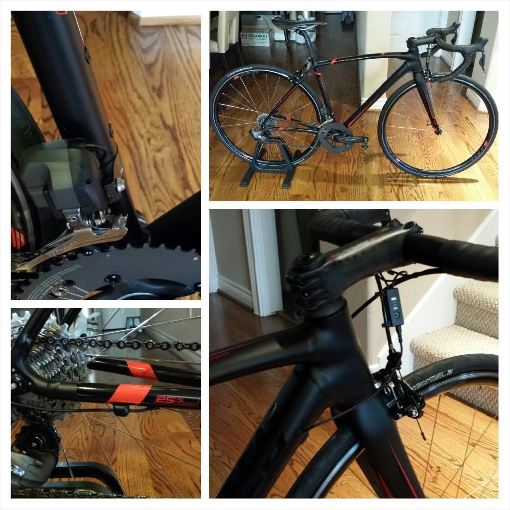

2014 Specialized Allez Expert, bought as complete bike and parted. Built frame with Ultegra Di2, drilled holes, shaved cable stops. Big thanks to Anders for his CAAD10 Di2 work. Will post parts and weights soon.
2 rides so far and it performs as advertised. Highly doubtful I will go back to carbon.

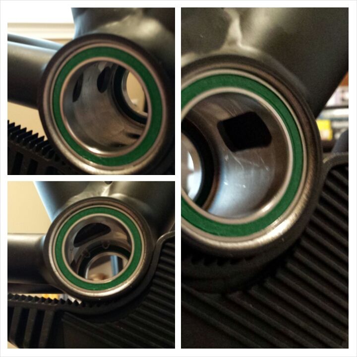

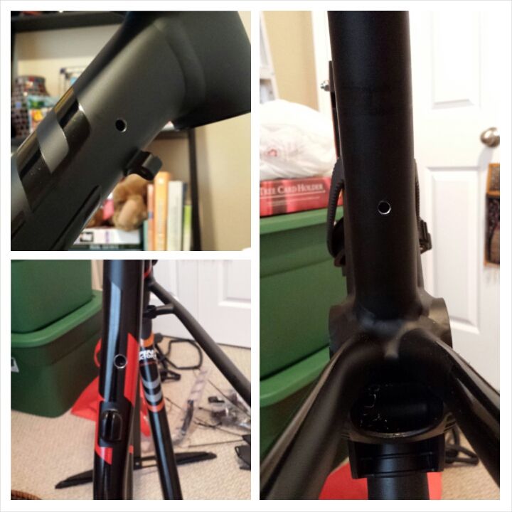

Nice! Would like to se some up close pictures of your drilling modifications.

Nice build, I think the osyms are a nice touch and I usually hate seeing them. I'd like to see some close-ups of the drilling too.
How hot is the frameset in real life? I've been looking into the '14s and have been a bit put off by the red detailing, especially on the forks and downtube after what the blacked out 2013 looked like. Makes me wonder whether the S-Works Allez I've been dreaming of is worth the extra coin considering the welding's basically identical.

Holes drilled in downtube, seat tube and chainstay. I have an internal battery that hides in the seatpost/seat tube, junction B is shoved in rectangular slot in BB/downtube.

Thanks, the rings are Dovals from Korea which are much better quality than osymetric. I have a project black venge so a little color was nice for me. The S-Works Allez is definitely NOT worth it since i believe the Expert frame is practically the same and the Race is not that far off either. Good luck!

Thanks. How did you close up the holes? Some kind of rubber sealing?

Elrey wrote:Thanks. How did you close up the holes? Some kind of rubber sealing?
Used this grommet kit for 6mm holes: Shimano E-Tube Di2 Grommet SM-GM01

Cheers for that. The drilling looks neater than a lot of DIY jobs I've seen, you planning on tidying up the junction box under the stem? Have to say it's nice to see a decent bar drop as well.

Thanks, I used a Ti drill bit and cleaned up the bore using a dremel. Yes, definitely have to tidy up that mini nest under the stem.

I'm going to be drilling my alu Heckler soon for a dropper post - how did you drill the holes? Did you start with a smaller pilot hole then a bigger bit?

Thanks! I first used a centerpunch to mark the spot, then about a regular 3mm drill bit, finished the job with a 6mm Ti bit. Make sure you tape the bit a little from the tip so it will stop you from drilling any further since the tube diameter is small, especially on my rear chain stay. Keep the bit moving at all times even when withdrawing the bit, this will keep the bore clean. I finished off with a sanding stone bit on my dremel to get rid of any sharp edges or burrs, you can use a file as well. Good luck!
