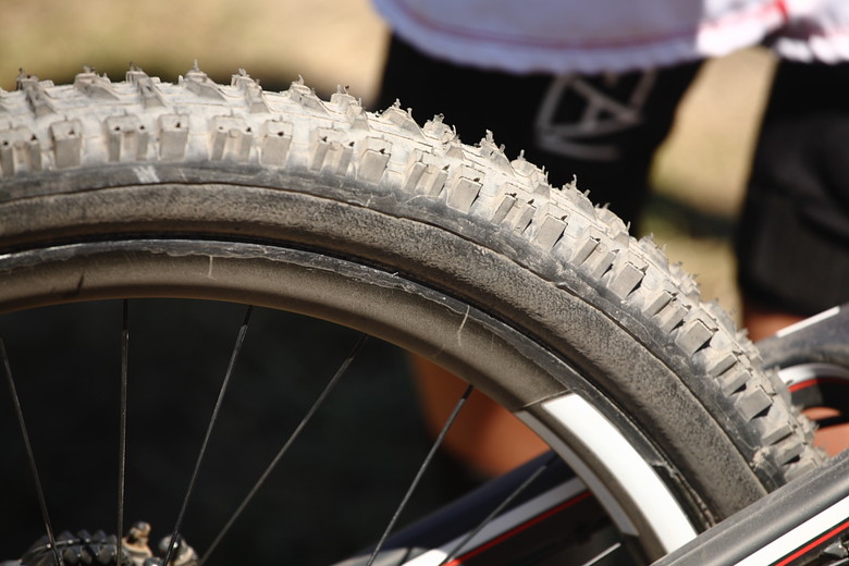

Tubular DH rims/ tyres have been tested for a while and I guess the ENVE connection in the team helps drive this. They were ridden at the Sea Otter before last and tested during the WC season this year. Some mention of this at Windham for example
{USERNAME} wrote:
http://www.pinkbike.com/news/qualifying-windham-dh-world-cup-6.html
Yeah Josh got first qualifier so I am really stoked for him. Now I'm going through all the preparation applying tubular tire glue to his training rims, making sure the spare tires are good and making sure his race wheels are fast for tomorrow.
There was a longer article on Pinkbike about it but I can't find it quickly.
The theory of Tubular set ups potentially offering a better balance of grip, rolling resistance, weight and protection against the tyre blowing off the rim all sounds better than the Procore approach. I know a lot of XC guys already ride tubular but getting the DH side of MTB interested in it too could be very interesting for MTB specific developments and tyre design/ availability. I'd be much more interested trying tubular tyres/ rims for XC before Procore but it is nice innovation from Schwalbe.

They weren't riding tubulars. They used tubular glue as an additional safety measure to keep the (clincher) tires stuck to the rims.

That makes more sense about the tubular glue being for increased security on clinchers vs. actual tubular tires being used in DH. I remember seeing Tomac's mechanic putting little strips of tubular glue on the beads of his DH tires in the early 2000s, even though he was running tubes in his clinchers. The reason being that he was getting the tires spinning on the rims under hard braking, which was tearing the valve stems, or at least it had the potential to do so. Low pressure doesn't press the tire/rim interface together hard enough I guess.

Perhaps the quick Pinkbike quote wasn't the best but Minnaar in particular has been reported as testing Tubular DH tyres/ rims. Pics are from Sea Otter (non event) but he was also reportedly testing at Fort William recently too. The pics were reported as tubular tyres although I wouldn't know how to be sure of this besides seeing a crudely attached tread to a casing and then the casing in turn glued to the rim. Looks like a (crude) tubular based on that. It is true that Tubular haven't seen a proper UCI DH race run yet (that much I am certain) but every now and again they pop up on Syndicate bikes under testing in news articles (believed to be Maxxis treads on Dugast casing).... I guess the demand for tyres is too low at the moment and casings not tough enough yet to trust for a race run although in principle I like the idea

That just looks like a normal clincher, although you could use a clincher rim and make it 'tubular' by bridging across the inside of the tyre saving circa 150g on the bit of the tube that is inside the tyre.

I don't honestly know if it is a tubular tyre or not, just that the Pinkbike/ Vital MTB/ etc reports label them as such. Certainly looks like a tread glued on too some sort of casing but the casing doesn't look particularly tubular-esque to me :?
Also, great gluing job by the mechanics :D
